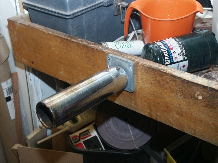

I used a chrome tailpipe tip for years to do venetian cutaways before i went over to a fox style bender. The tailpipe tip come with the screws to attach it to something. I attached it to a base I found in the electrical dept at the local home depot.

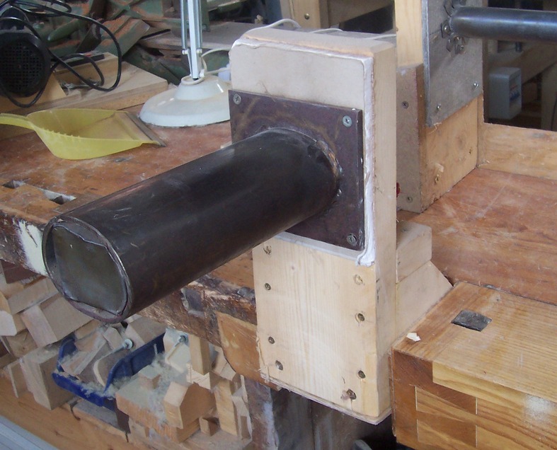

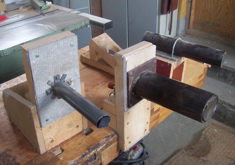

Here are some pictures of my pipes. I use 3 different sizes, all heated by propane torch (because I had one and it works!). They are all steel of varying diameters and thicknesses, mounted on some scrap wood bases.
The one on the left gets used for things like mandolin ribs, but it has thin walls so it does not retain heat so well and it can also scorch the wood if I am not careful. The middle one is the one I use for guitar sides, it is 4" pipe that is somewhat flattened into an oval shape and welded to a flange. The one on the right is just really thick walled 2" steel pipe, but it is hard to get it hot enough so I don't use it much. I now mostly use these for touch ups as I have a Fox style bender.

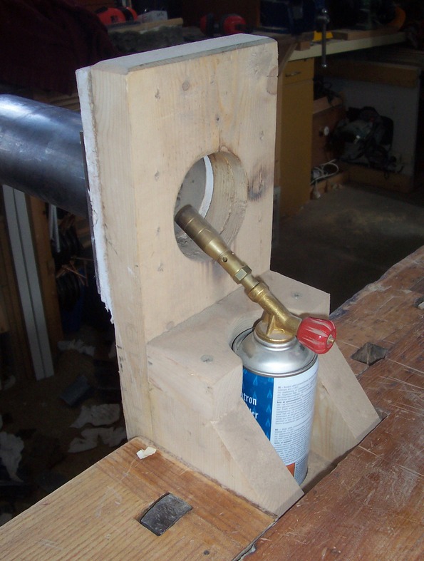

Here is the back, you see how the propane torch blows its flame into the a hole in the flange.
